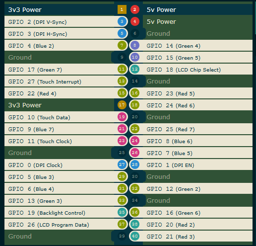

Was wondering if there is a portable power solution for the Raspberry pi 5 that doesen't interfere with gpio signal.
I would like to use a screen like the pimoroni hyperpixel touch which uses all the gpio pins for it's interface. I have a x1209 but it uses gpio 6 and gpio 16 which means they probably wouldn't work togheter. Any solutions or workarounds?

You should check if the Pimoroni Hyperpixel Touch is actually using GPIO 6 and GPIO 16.
0 likes 0 likes
@Harry Huang, the pins are marked as used
